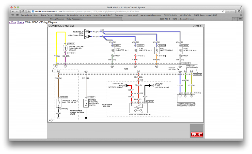

je t'ai trouvé ça:
Source:
http://ncmiata-servicemanual.com/Servic ... 140-e.html
