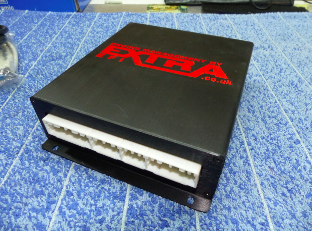

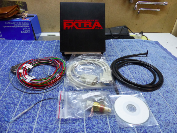

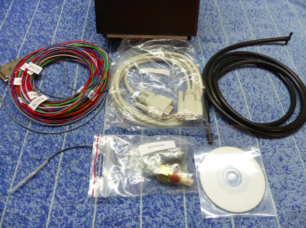

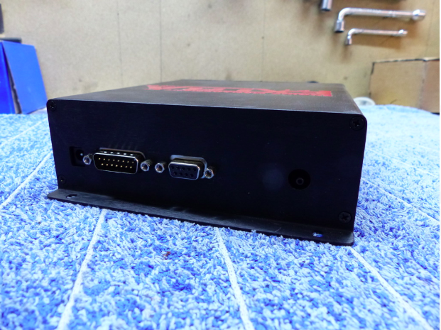

JE te remets le descriptif et les photos :
16x16 Fuel table
12x12 Spark table
Rev limiter
Over-boost protection
Mappable Air:Fuel ratio targets
Wide band or Narrow band
Coolant temperature related ignition timing advance
Inlet air temperature related ignition timing retard
Manifold absolute pressure rate of change or Throttle position sensor rate of change acceleration enrichment
Overrun fuel cut
Boost control
Built-in air density correction
21PSI MAP sensor
Knock sensor input with adjustable sensitivity
Table switching input. Change fuel and spark maps on the fly for different fuels, nitrous activation ect
Kit includes:
Air temperature sensor (Allows removal of AFM)
2 meter loom for air temperature sensor
Wideband lambda input
Knock sensor input
Switchable map input
Programmable output (warning LED, or relay control)
MS2 Based PnP ECU
RS232 COMMS cable
Tuning software and Documentation CD
MX5 base map pre-loaded
1.5 meter vacuum hose for MAP signal and "T" fitting
Wiring PDF HERE
PnP CD HERE
