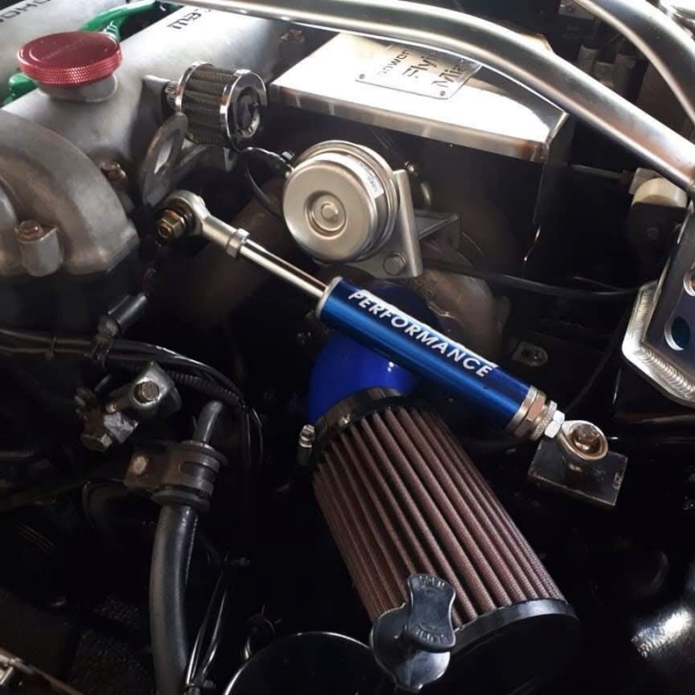

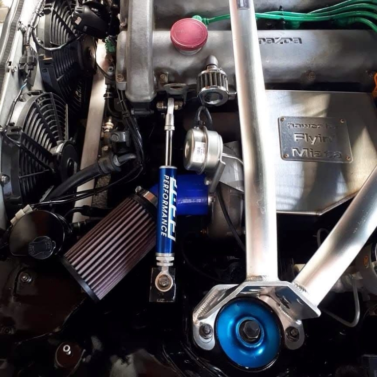

Tiens j'ai trouvé ça sur le net, j'ai exactement le même.
Bon, sinon il commence à faire frête par icite, 5°c ce matin.

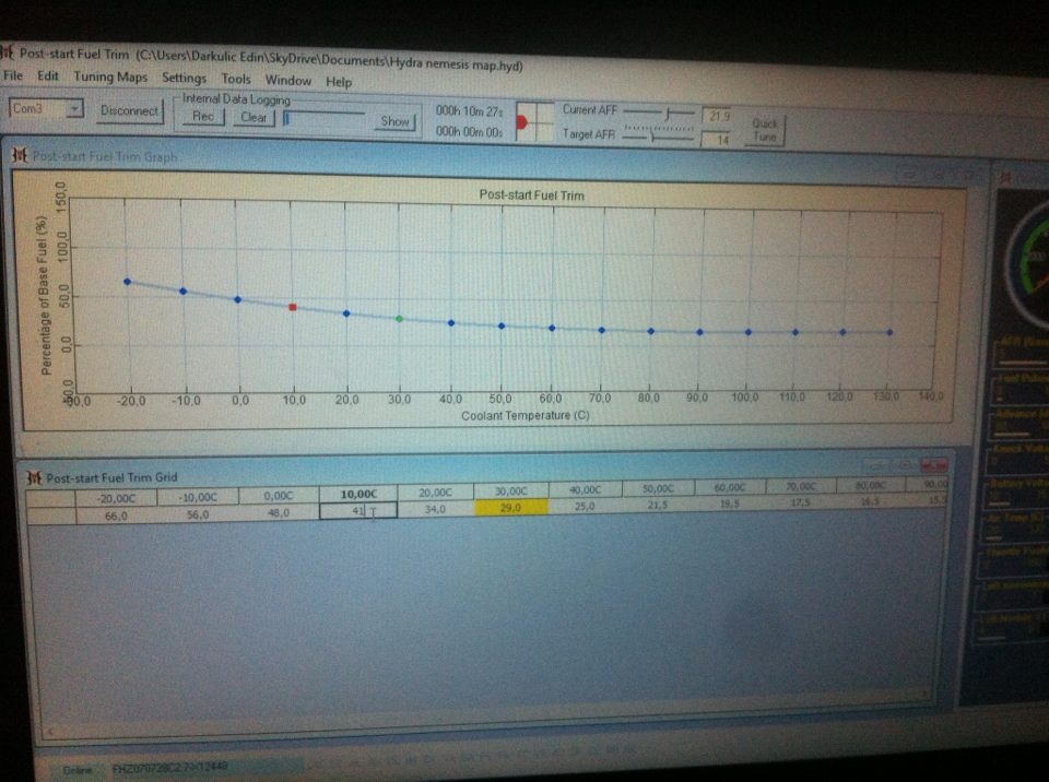

Les démarrages à froid commence à être difficile, il va falloir que je touche à la cartographie pour régler ça.
J'ai jamais fais ça mais ça m'a pas l'air compliqué.
Si vous avez des conseils sur Hydra Nemesis 2.7 je suis preneur.

Appelle le et propose lui un live mapping via tuner studio ou autre.
Les démarrages à froid et autres sont compliqués à mapper car impossible à reproduire plusieurs fois dans un temps court.
Mon mappeur garde généralement la voiture 1 semaine pour pouvoir tout mapper.

Voilà la réponse de FM:
Hi Edin,
It sounds like your Post-start Fuel Trim map (Tuning Maps > Starting) needs some adjustment during cooler temps. Before starting your car for the first time in the morning, check your current coolant temp on the dashboard to find what area you need to adjust on the graph. Start by raising that point about 10% to see if the idle quality right after starting the engine is improved. This is a bit of a lengthy process since you only get one true cold start per day, so it will take a little while to really get it dialed in just right. Once you have a few points of the colder areas of your Post-start Fuel Trim map developed to where the engine will be idling relatively happily at those temps, then you should manually interpolate between the warmer areas of that map that you didn’t adjust so that the graph is smooth. The curve should still look like an exponential plot line, similar to a skate ramp, so manually adjust the values between what you’ve found to be happy spots for the warm and cold fueling to be a smooth transition. Remember, the AFR readings won’t be very accurate for the first minute or so that the engine is running as the WBO2 sensor needs to warm up to normal operating temperature to obtain accurate readings, so this part of determining the correct fueling after cranking is mostly done by feel – the smoother feeling engine, the better.
This information about adding fuel to start the engine smoothly is predicated on the assumption that your base fueling table is in the ballpark of what’s accurate for your engine. If your base fuel table isn’t very well dialed in, you may be chasing your tail by making adjustments to these tables before having the base fuel table dialed in. All of the fueling logic starts at the base fuel table and then runs through the other fuel modifiers as necessary to come up with the end result that actually delivered into the engine.
If you’re not sure about any of this info and you’d rather have a professional shop make the changes for you, you’ll need to plan on dropping your car off a dyno shop so that it can be further dialed in. We do have a number of professional shops that we recommend (https://www.flyinmiata.com/support/installers.php), though there are likely other dyno tuners in your area that can help you out as well. You might ask Marc-André to see if he can recommend a place that he’s used when he owned the car.
If you do want to familiarize yourself more with the Hydra Nemesis ECU, we do have a lot of information, instructions, and base maps hosted on our Dropbox site, here: https://www.dropbox.com/sh/sx3bf5mkwhgb ... Ads7a?dl=0. This is a good reference source if you need help finding out specific information regarding the Hydra and the different settings and tools that we’ve found that work well for these cars.
Please let me know if you have any other questions .
Mike Usrey
J'ai été bombardé d'infos, mais ça me fais pas peur.
En effet je me sens d'essayer tout ça par moi même, car j'ai pas confiance aux professionnels d'ici et que de toute façon j'ai toujours rêvé de m'amuser avec une ECU programmable.
Sinon j'ai réservé un emplacement pour remiser mon char cette hiver, ce sera l'occaz de compléter un peu l'équipement manquant pour quelques sorties track day l'année prochaine.
Message Publié : Dim 16 Sep 2018, 08:21
Message(s) : 7687
si tu veux juste touché ta carto d'enrchissement au démarrage, les instructions données sont bonnes et c'est facile a faire ;) ..... faut ce lancer :D

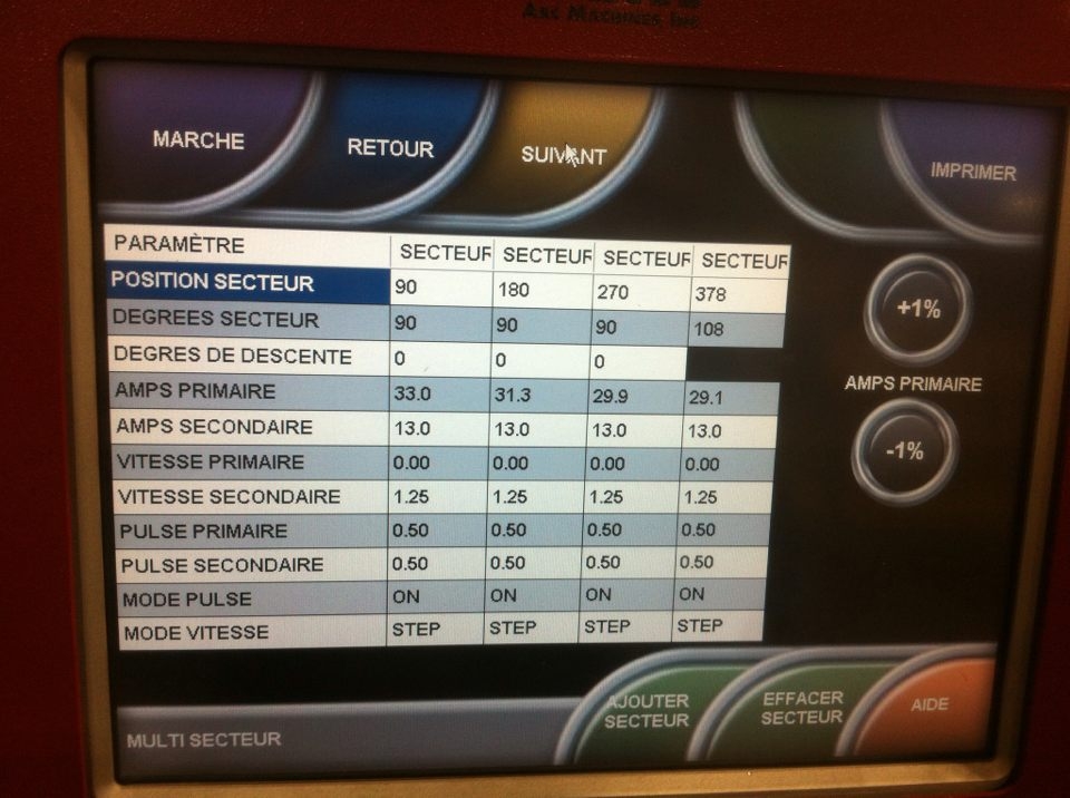

Jme suis lancé!!! :woo:
En fait ça me fais beaucoup penser à mon job du moment.
Voilà l'écran de ma soudeuse orbitale.
Je suis parti de ça, je peaufine un peu tout les matins. Je vois des améliorations.
