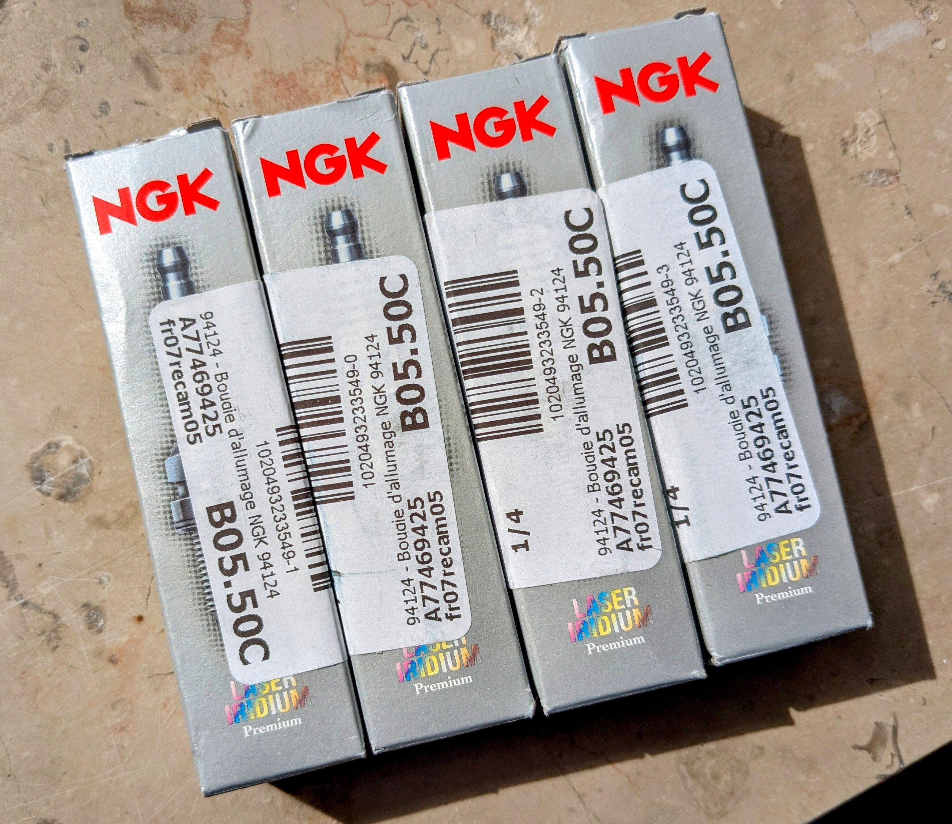

En concession Mazda, 1 bougie vaut ~42€ HT. :idea:
Voici les références (merci Aerogela ;) ) :
- Bougie NGK 1LKAR7L11 == P51R-18-110 9A (ref Mazda)
- Bougie Denso ZC20HPR11 == P51R-18-110 9A (ref Mazda)
Et une 3ème référence (merci lolo94 ;) ) : REA8WYPB4 (Champion Iridium)
Les bougies Mazda sont un peu moins chères ici :
https://www.mx5parts.co.uk/spark-plug-genuine-mazda-mk4
Sinon les NGK / Denso sont trouvables chez les revendeurs habituels, autour de 20€-25€ pièce...

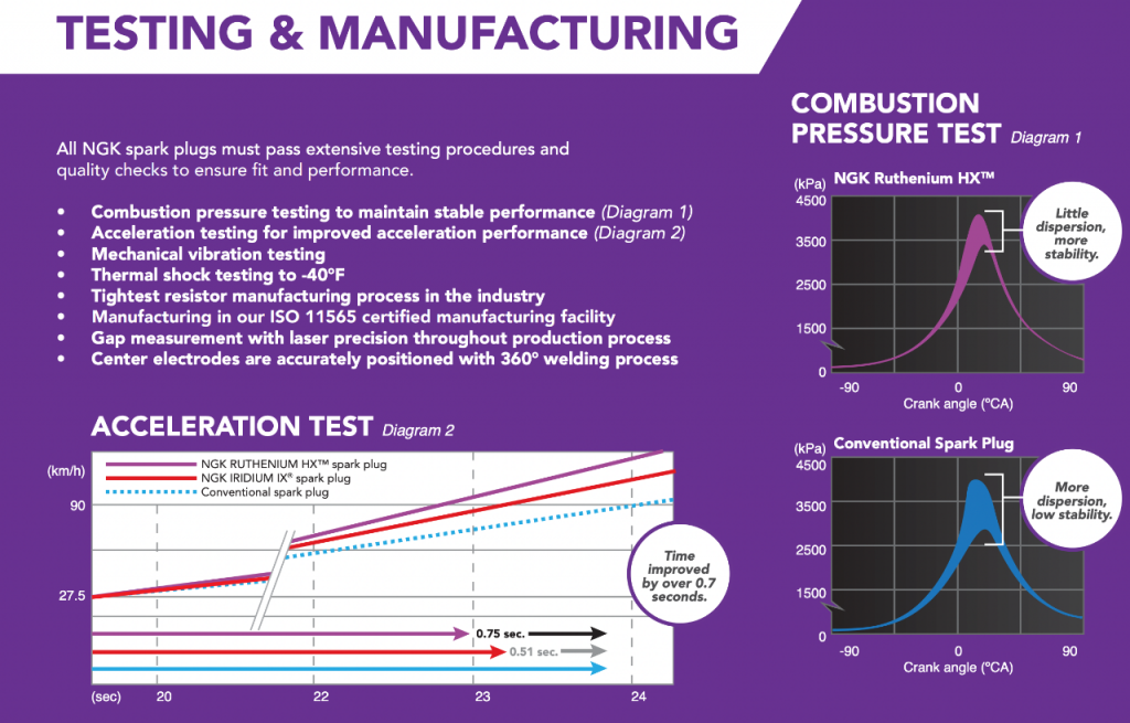

Et même davantage si on regarde les specs des bougies NGK iridium :oops:
https://www.ngk.com/ngk-94124-ilkar7l11 ... spark-plug
Longevity : 100k Miles
A priori, les bougies au Ruthenium dureraient encore + longtemps, certaines sont données pour 120k miles... :etonne:
D'ailleurs il y a un topic sur le gain "ressenti" avec ces bougies :tantpis:
https://forum.miata.net/vb/showthread.php?t=761356
I DID notice a change in the engine operation. Idle is smooth as silk. The engine note sounds different with the top up, both under moderate and WOT acceleration. I haven't driven top down yet so can't comment on that. The power delivery feels and sounds smoother. I felt a bit of a power bump as well. Now, of course, this may be simply because they are brand new plugs, but these have been interesting observations. Again, it is not placebo as I was not expecting anything other then longer life
Definite improvement; smoother at idle, off idle on takeoff, and better response
